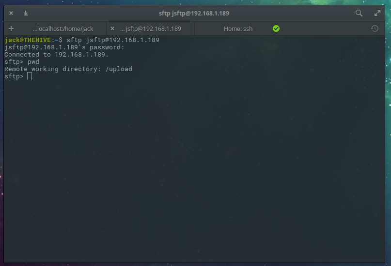

Logging in
You're all set to log in. From another machine on your network that has SSH installed, open up a terminal window and issue the command:
sftp USERNAME@SERVER_IP
Where USERNAME is the name of our new user and SERVER_IP is the IP address of our SFTP server. You will be prompted for USERNAME's password. Once you successfully authenticate, you will be greeted with the sftp prompt. Type pwd to check the working path and you should see /upload (Figure A).
Figure A
